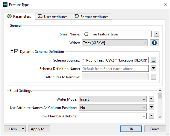

In most cases, you can use the default schema properties of the dynamic writer. However, there are some parameters you can adjust.
To display dynamic schema parameters, open the writer Feature Type dialog.
General Parameters
See Editing Writer Feature Types.
Dynamic Schema Definition
To view, check the Dynamic Schema Definition box.
Schema Sources: Click the browse button to select from a list of existing schema readers. Only the readers that you have selected will be used at runtime. If Schema from Schema Feature is selected, the writer checks the first feature for the presence of a specific type of list attribute that provides schema information. If this list is found on the first feature, it can be used to generate the output schema for the writer. For more information, see Deriving Destination Schema from Schema Feature.
Schema Definition Name: Defines how elements in the schema definition of the feature type are named. By default, schema elements are named based on the feature type name, under General Parameters. Alternatively, you can name schema elements based on a specified attribute.
Attributes to Remove: This option allows you to remove attributes from the feature. Click the browse button and enter the names of any attributes you do not want in the destination feature.
