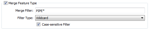

For example, if you have a "PIPE145" feature type in your workspace as an input feature type, and you know there are many other feature types that have some sort of PIPE designation, open the Feature Type dialog, check the Merge Feature Type checkbox, and enter a pattern that any incoming feature type would have to match in order to be considered the same as PIPE145. So, you could enter:
PIPE*
as shown in the example above. You can also uncheck the Case-sensitive filter so that even if an incoming feature type is "pipe" or "Pipe", it will be matched.
