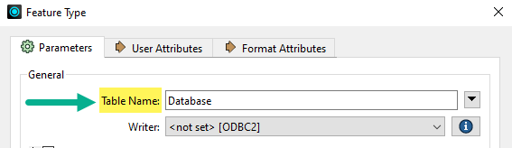

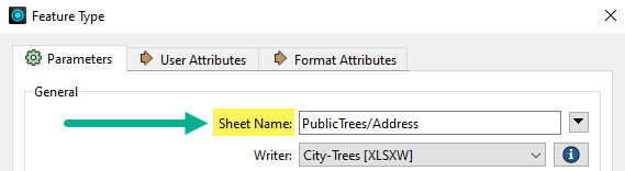

Similar to editing the schema, the Parameters tab can be used to define the new feature type’s name.
Feature Type names use format-specific terminology, so the label might be Feature Class, Layer, Sheet Name, Table Name, or whatever terminology is specific to the format of data you are writing: |

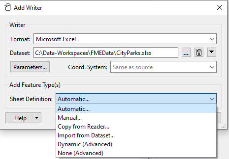

When you are adding a new Writer, you can also control the feature types that are added to the workspace:
There are six options for adding feature types:
- Automatic: Adds a new feature type with the attribute definition parameter set to automatic. This is the default.
- Manual: Adds a new feature type with the attribute definition parameter set to manual.
- Copy from Reader: Adds a new feature type with the attribute definition parameter set to manual, but predefined to the schema of an existing Reader feature type.
- Import from Dataset: Adds a new feature type with the attribute definition parameter set to manual, but predefined to the schema of an external dataset (just like using the Import Feature Types tool).
- Dynamic: Adds a new feature type with the attribute definition parameter set to dynamic.
- None: Does not add any new feature type.

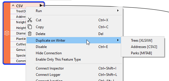

When adding a Writer, it is possible to create a new feature type whose attribute schema is predefined to that of an existing Reader. However, if you already have a Writer, you can still carry out the same procedure of copying a Reader schema. This is simply done by selecting the required Reader feature types, right-clicking them, and using the option Duplicate on Writer.
The command causes duplicates of the Reader feature types to be added to the writer, and source/destination feature types to be automatically connected.
