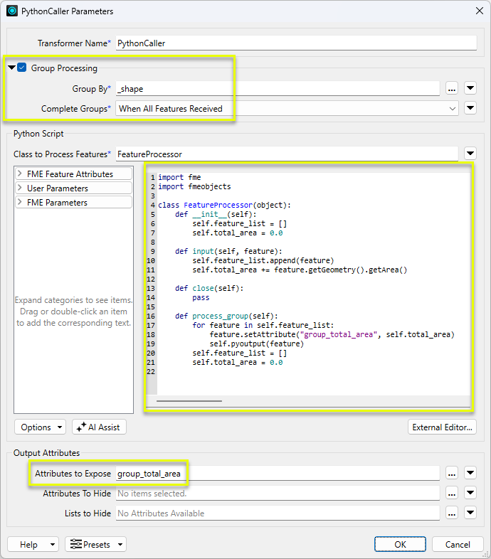

Group Processing Mode
This is the feature processing mode used when one or more attributes are set in the Group By parameter. When using this mode, bulk mode must be disabled by altering the has_support_for() method to return False when the support_type argument is equal to fmeobjects.FME_SUPPORT_FEATURE_TABLE_SHIM.
In this mode, the PythonCaller will have the following calling sequence on a class:
- __init__() - Called once, whether or not any features are processed.
- input() - Called for each FMEFeature in a group.
- process_group() - Called after all FMEFeatures in a group have been sent to input(). After this is called and executed, PythonCaller will send the next group of FMEFeatures to input() and then call process_group() again. This is repeated until all groups have been exhausted.
- close() - Called once, after all rounds of input() and process_group() have been called to process all incoming features (when no more FMEFeatures remain). If no features are processed, the close() method will still be called.
In this mode, the class interface will be working on groups of FMEFeatures. The incoming FMEFeatures must be stored in a list class member variable, then processed and written out through pyoutput() in the process_group() method. After processing is complete in process_group(), all class member variables should be cleared for the next round of group by handling. In the next round, FMEFeatures of the next group are passed through input() calls followed again by process_group(). This is repeated until all the groups are exhausted.
The example below calculates the total area of all features grouped by the _shape attribute and then outputs all the features with a new attribute containing the total area for each group:
