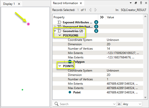

In this example, we have a set of features with multi geometry. Note that two geometries exist on the feature, and are named POLYGONS and POINTS. We want to rename them to something meaningful.

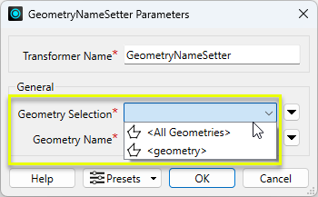

The features are routed into a GeometryNameSetter.
In the parameters dialog, note that the geometry names are not available for selection. They need to be exposed before renaming.

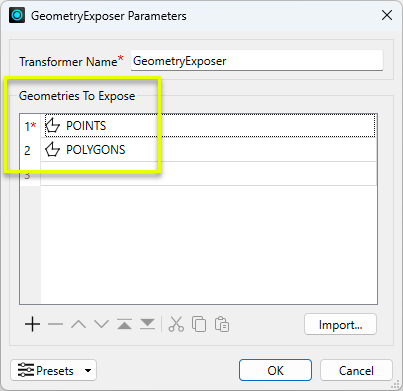

A GeometryExposer is added prior to the GeometryNameSetter.
In the parameters dialog, both geometry names are added.

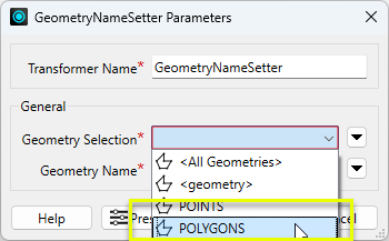

Now the names are available for selection in the GeometryNameSetter.
The selected name is changed.
