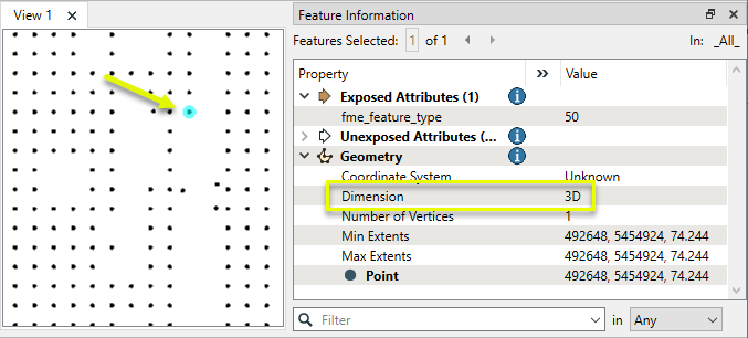

In this example, we have a CAD file of 3D elevation points, and want to access the z values as an attribute.

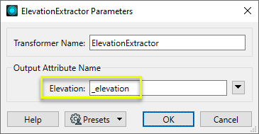

In the parameters dialog, the Elevation output attribute is left with its default name.

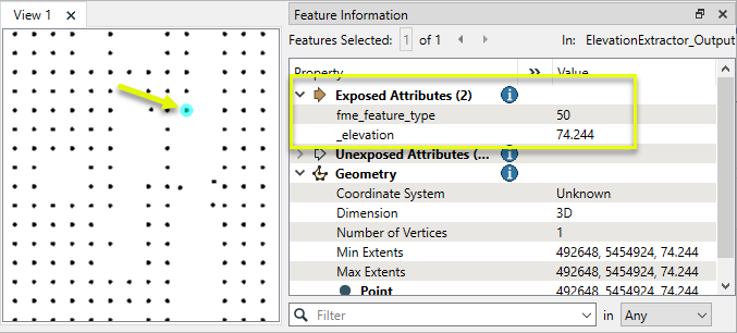

The output features have a new attribute containing the extracted values.
Features with an attribute containing elevation values.
