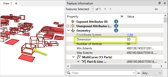

In this example, we have a set of building footprints, some of which have been extruded to their above-ground height and made into 3D objects.
We want to isolate the features that are still 2D in order to work on them.

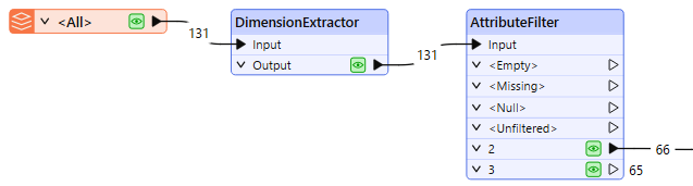

The features are first routed into a DimensionExtractor, and then on to an AttributeFilter to separate them.

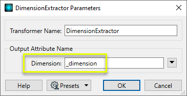

In the parameters dialog of the DimensionExtractor, the default Output Attribute Name for Dimension is kept.
The features are then filtered based on the _dimension attribute.

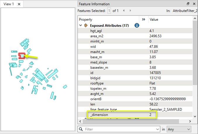

Inspecting the results from the 2 output port, we see only the 2D features, with a _dimension attribute value of 2.
