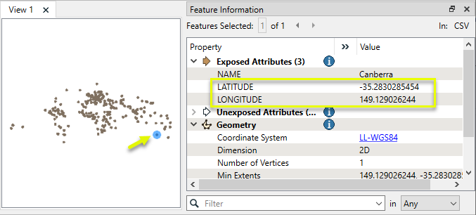

In this example, we have a dataset of world cities. The features have decimal degree coordinates as attributes. We want to convert those values to DMS.
The features are routed into a DMSCalculator.

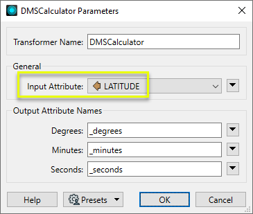

In the parameters dialog, Input Attribute is set to LATITUDE. Attribute names for the converted values - degrees, minutes, and seconds - are left with their defaults.

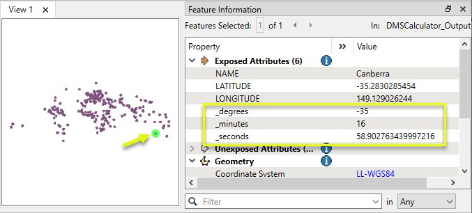

The output features have three new attributes, containing the converted values.
