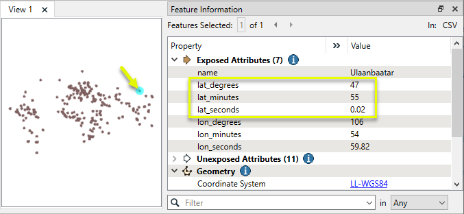

In this example, we have a dataset of world cities, with latitude and longitude coordinates stored as attributes, in degrees, minutes, and seconds.
We want to convert these into decimal degree values, and will start with latitude.

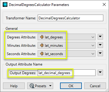

In the parameters dialog, Degrees, Minutes, and Seconds Attribute(s) are set to the corresponding latitude attributes - lat_degrees, lat_minutes, and lat_seconds. The default output attribute name is prefixed with lat_.

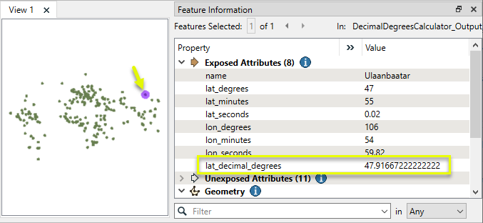

The output features now have a lat_decimal_degrees attribute, containing the calculated decimal degree value.
