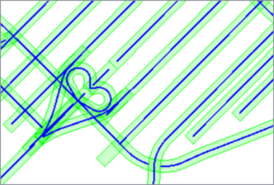

Centerline
Centerlines generally are better for long narrow polygons. The result resembles the shape of the input feature, and is approximately equidistant to the boundaries on either side.

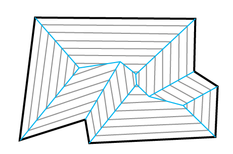

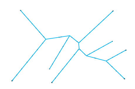

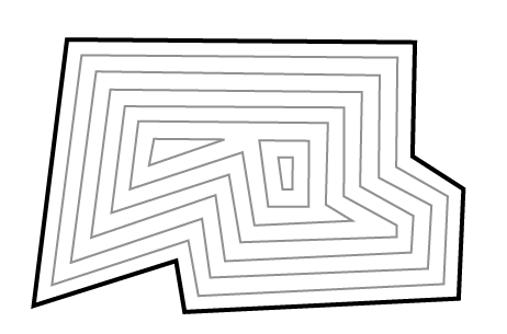

Straight Skeleton
The area boundary’s edges are moved inwards, parallel to themselves. When they collide, the polygon is split, and the process continues. The paths traced by the vertices where edges meet are the skeleton.
Note that generating straight skeletons on complex polygons can require long processing times.

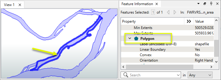

In this example, we have a set of detailed river polygons. Note the structure, with multiple discrete polygons instead of more complex donut polygons.
We want to simplify this to a single-line representation.
The features are routed into a CenterlineReplacer.

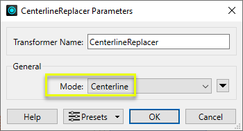

In the parameters dialog, Mode is set to Centerline.

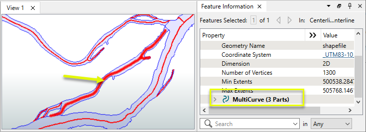

The output features are linear.
The discrete polygons have produced centerlines that do not intersect, and they are perhaps more detailed than they need to be. Some pre-processing of the polygons - generalizing and dissolving - might produce better results.
- A BoundingBoxReplacer using 2D Oriented Bounding Box may be useful in some cases.
- The Dissolver, AreaGapAndOverlapCleaner, and Generalizer may be useful for pre-processing polygons.
