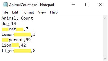

In this example, we start with a CSV file containing animal names and counts. Some animal names have varying numbers of extra spaces that need to be removed.

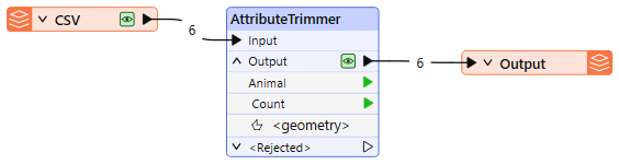

All features from the CSV file are routed into an AttributeTrimmer.

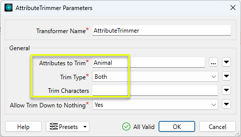

In the Parameters dialog, we select the attribute Animal for trimming, choose Trim Type Both to trim both the left and right-hand sides of the values, and leave the Trim Characters field blank - indicating we want white space removal.

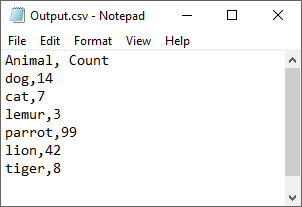

The resulting output has clean Animal values, with spaces removed.
