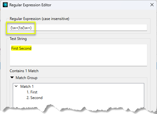

Using Match Groups
Match groups are created when sub-parts exist in the expression, enclosed in parentheses. Each part captures a sub-match from the input text.
These parts can be referred to in the Replacement Text by a backslash followed by the number of the part - \2 refers to the contents matching the second set of parentheses.
In this example, the expression describes a pattern of a word, then a space, then a second word. The words are enclosed in parentheses, and so can be used as a match group.
In the StringReplacer, it could be used like this:
Input |
Text to Replace |
Replacement Text |
Output |
First Second |
(\w+)\s(\w+) |
\2 \1 |
Second First |
- See the StringSearcher transformer help for additional regular expression examples.
