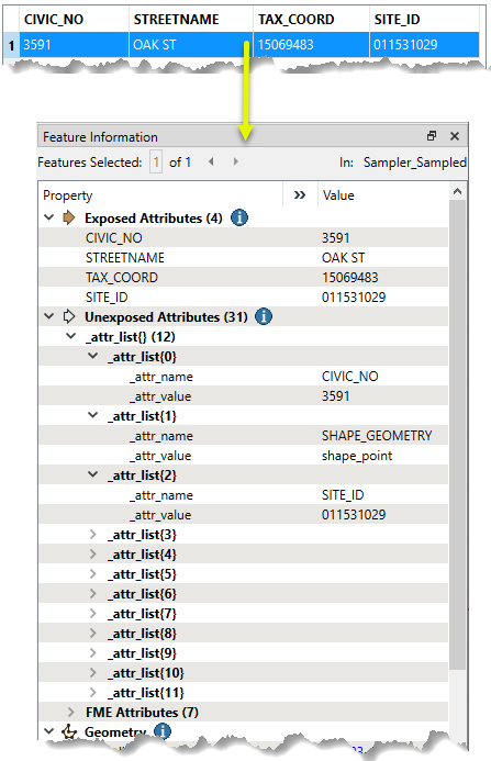

Exploding Type: List
If the attributes are exploded into a List, a new list attribute is added to the original feature.
The attribute names and values are added as list elements.
One (1) feature in produces one (1) feature out, with a list attribute.

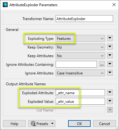

In the AttributeExploder parameters dialog, the Exploding Type is set to Features, and the default Output Attribute Names are kept.

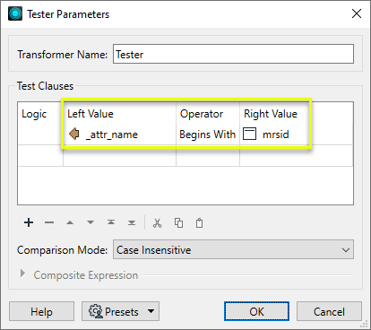

As the output will contain extra attribute types that we don’t want (reader and fme_ internal attributes), we configure a Tester to keep only features where _attr_name begins with the string “mrsid”.

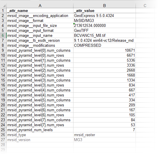

With an Excel writer, a spreadsheet is created (one row per feature), containing both the attribute names and values for the original raster.
