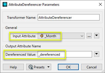

The AttributeDereferencer receives the name of an attribute in the Input Attribute parameter. The Input Attribute’s value references (is the name of) another attribute, and the value of this secondary attribute will be added to a newly created Dereferenced Value attribute.

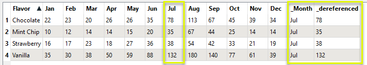

In this example, we start with a simple tabular dataset of Ice Cream sales numbers for a year.

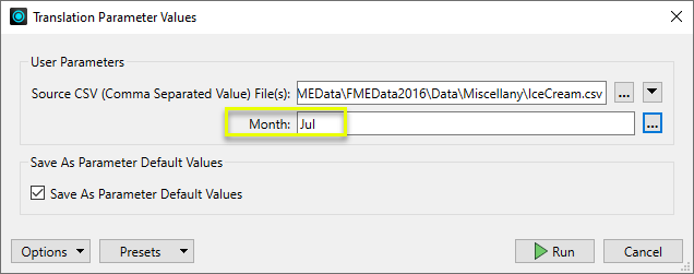

To extract the sales numbers for any given month, we create a simple workspace that contains a User Parameter called Month. It has been configured as a Choice parameter, and the possible Month values provided. Upon running the workspace (with Prompt), the user selects the month “Jul”, which becomes the current value assigned to the Month parameter.

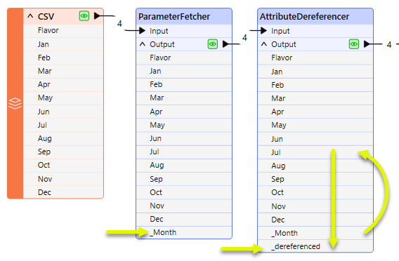

In the workspace, the features are routed through a ParameterFetcher and then on to the AttributeDereferencer.

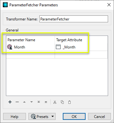

In the ParameterFetcher, the Month parameter’s value - “Jul” - is assigned to a new attribute named _Month.
Then, in the AttributeDereferencer, the Input Attribute is _Month, and the newly created attributeDereferenced Value has the default name _dereferenced.
The output features now have a _dereferenced attribute, the contents of which are determined by the User Parameter choice - in this case, “Jul”.
Features with attributes.
Features with a copy of the value of the referenced source attribute.
