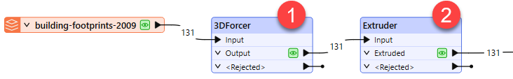

In this example, we have a set of 2D building footprint polygons, which have a number of attributes including base elevation and building height.
We want to turn these into 3D objects. Note that the coordinate system is UTM, with ground units in meters.
This will take two steps:
The features are routed into a 3DForcer to convert them from 2D to 3D.
The 3D features are extruded based on the building height to create objects.

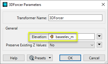

In the parameters dialog of the 3DForcer, Elevation is set to the value of the baseelev_m attribute, which contains the elevation of the base of the structure.
Note that the units - meters - match the ground units of the coordinate system. If they did not match (if the coordinate system was latitude/longitude, for example) the features would need to be reprojected before using the 3DForcer.

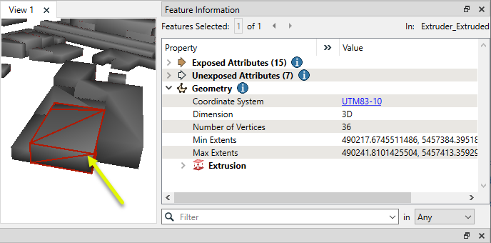

The output features are now 3D, with z coordinates obtained from the baseelev_m attribute. Though they now have an elevation, they have a height of zero (0).
The features are passed on to an Extruder, where they are extruded to their height above ground.
