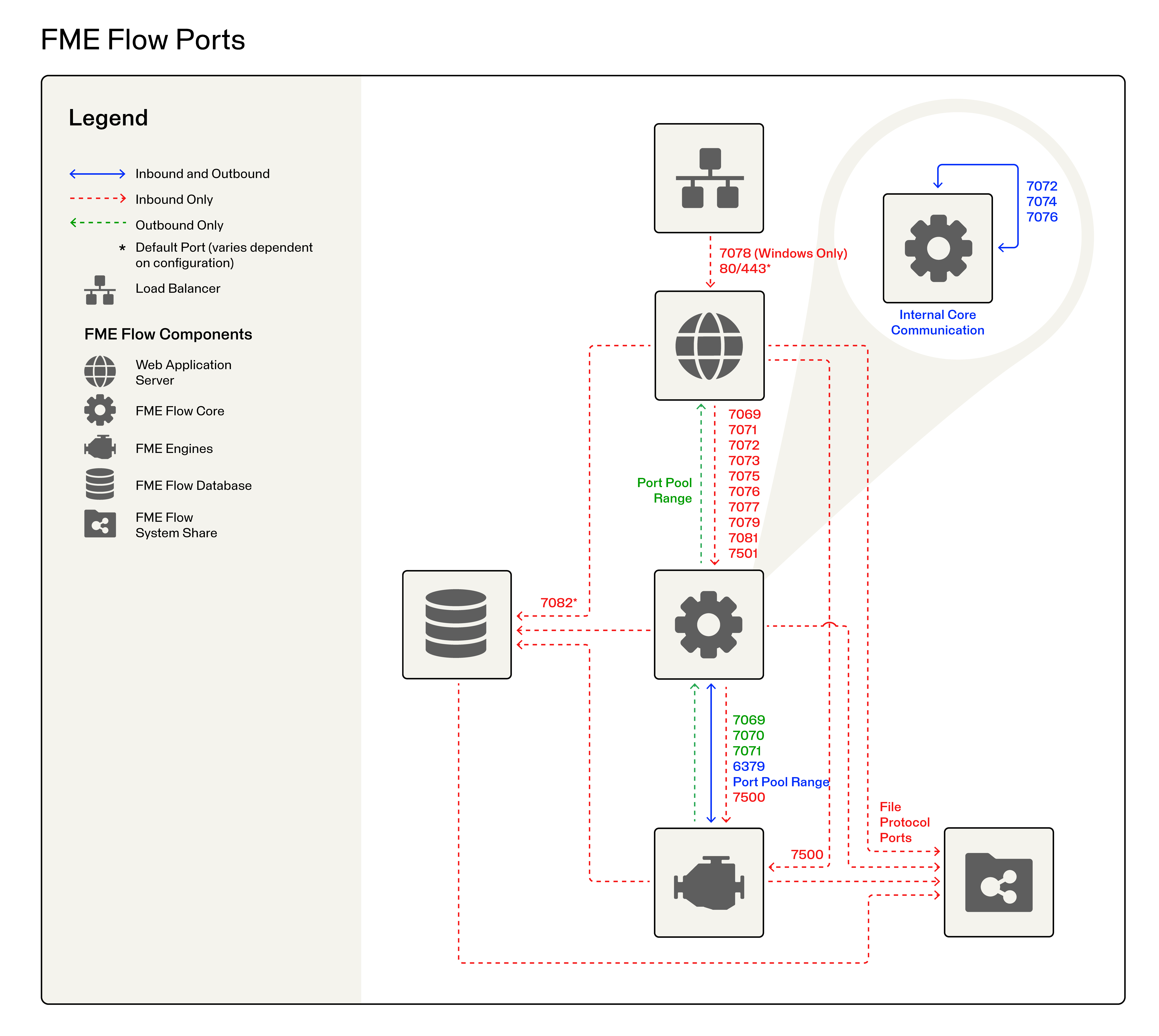

Diagrams of FME Flow Ports
Mouse-over for diagrams:
FME FlowPorts |

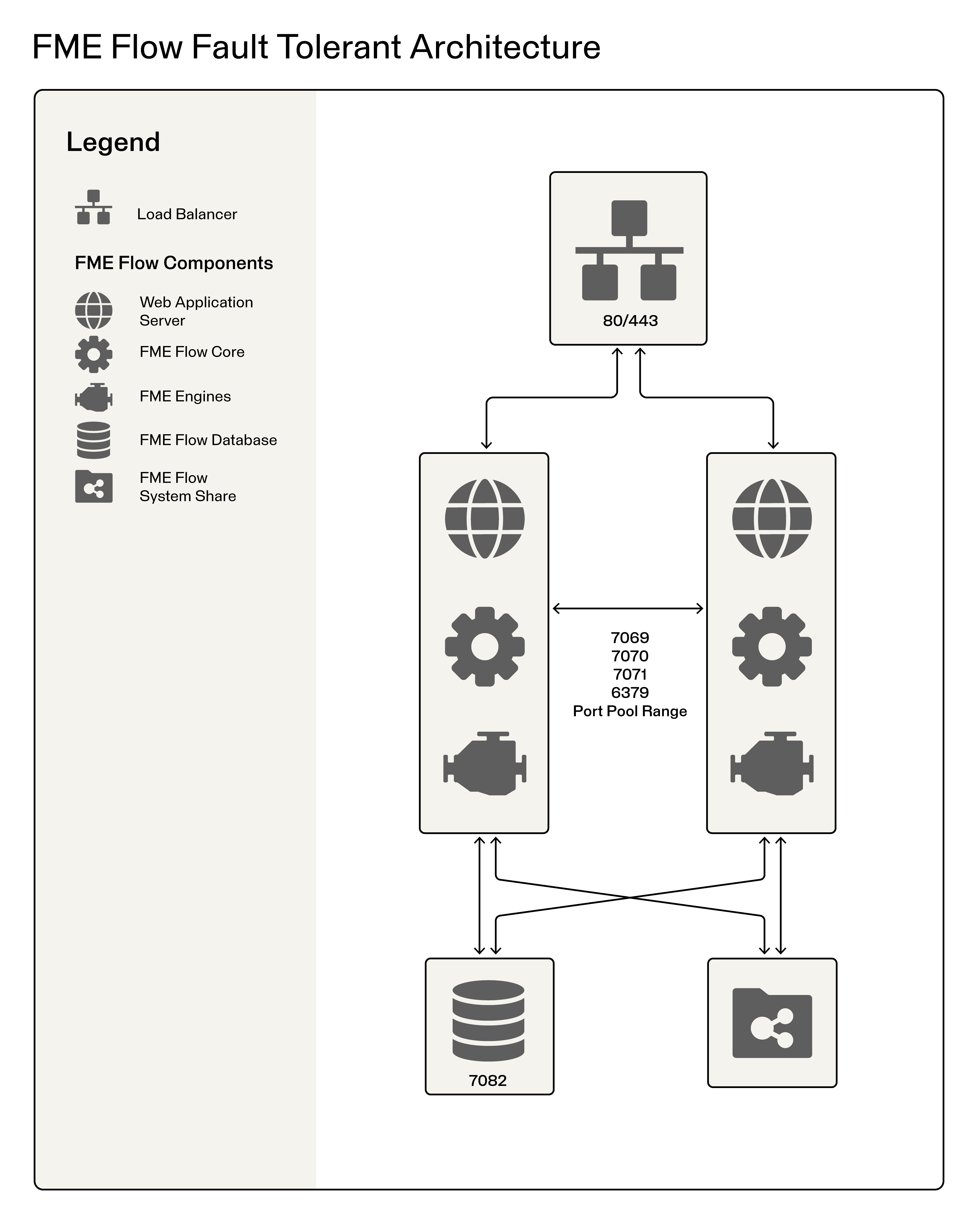

FME Flow Ports Specific to a Fault-Tolerant Architecture |
