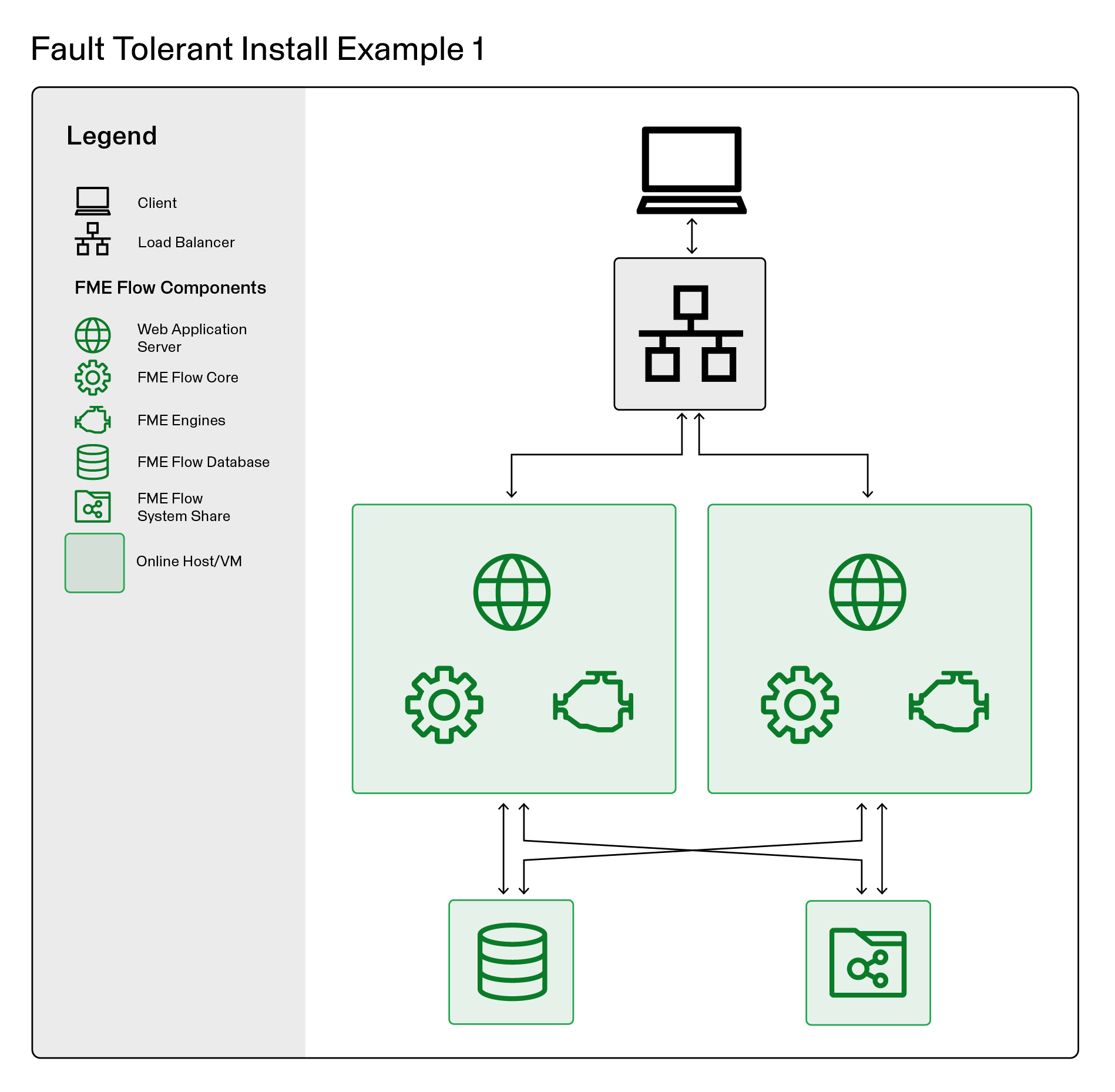

Example 1: FME Engines hosted on the same machine as the web application server and FME Flow Core
Mouse-over for diagram:

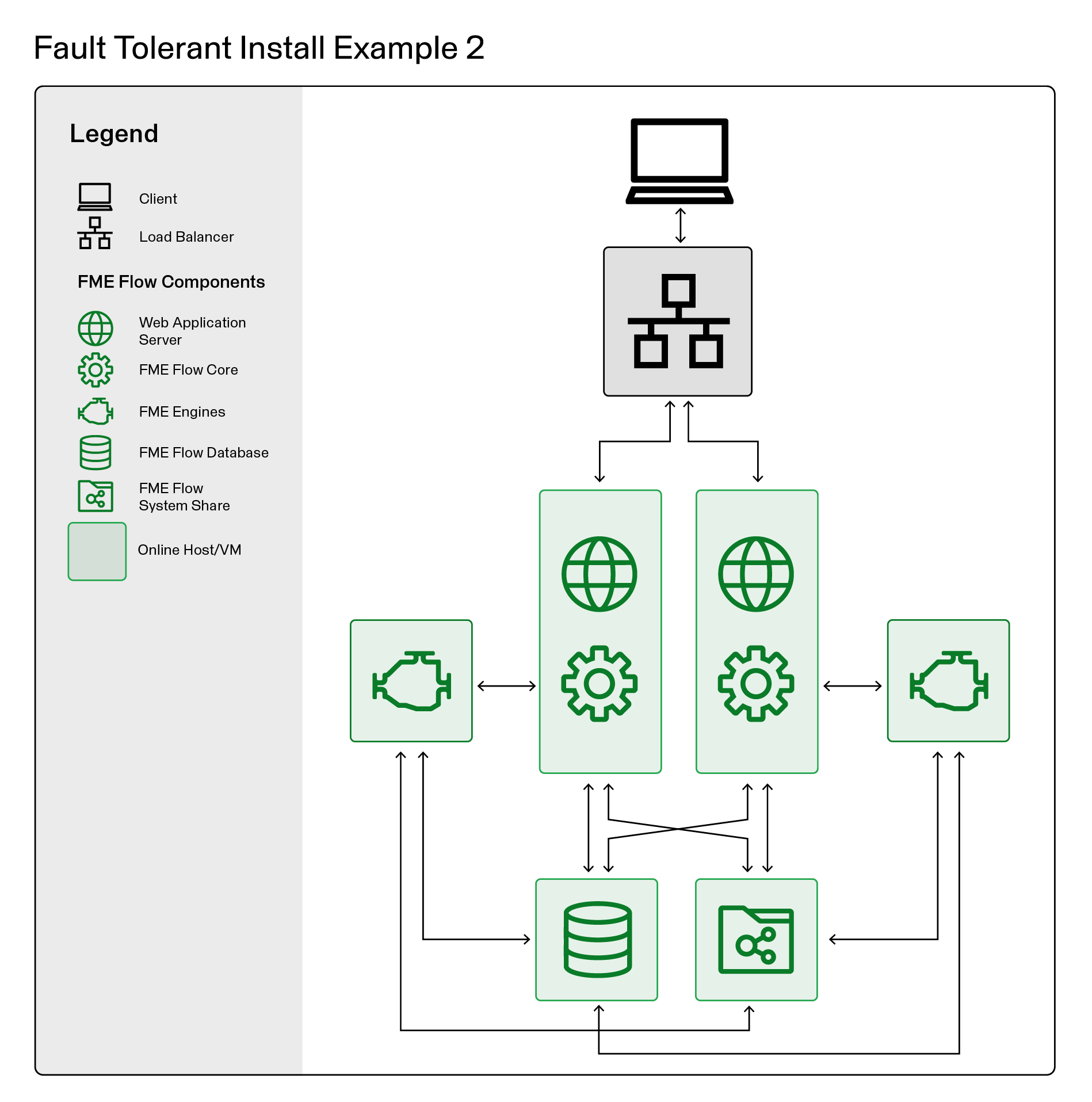

Example 2: FME Engines distributed and hosted on a separate machine from the web application server and FME Flow Core
There can be any number of distributed FME Engine hosts associated with the FME Flow Core.

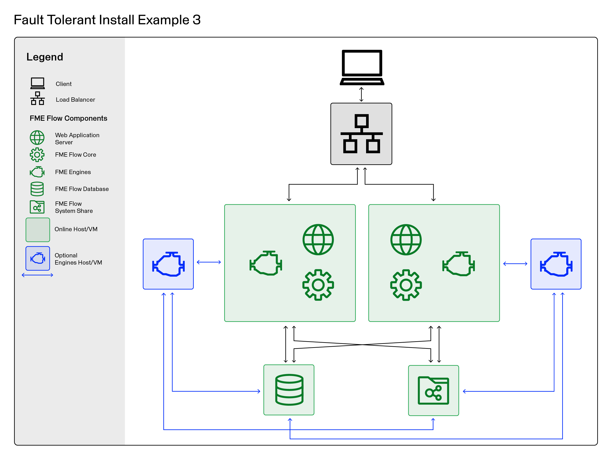

Example 3: A combination of examples 1 and 2
Some FME Engines are hosted on the same machine as the web application server and FME Flow Core, and others are distributed.
