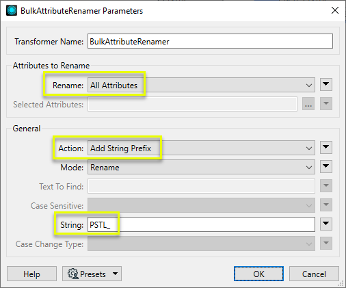

In this example, a prefix is added to all of the attributes.
The output attribute names are altered as requested.
