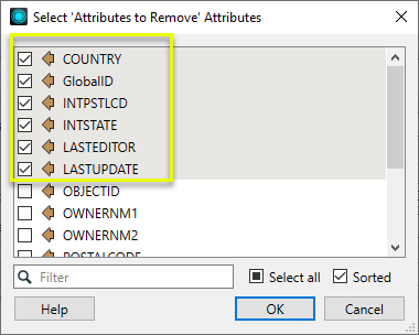

Once connected to input features, the AttributeRemover provides pick lists (one for attributes and one for list attributes) for you to choose which specific attributes to remove. All other attributes are kept, and the modified features are output.
In this example, several attributes are selected from the pick list for removal.

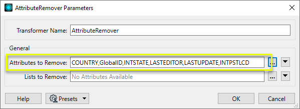

The Attributes to Remove parameter is populated with those choices.

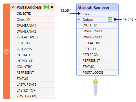

As the features exit the transformer, the selected attributes have been removed:

Attributes to Remove |
Click the browse button to display the list dialog. Select the attributes that you want to remove from the feature. The unchecked attributes will be retained. |
Lists to Remove |
After you connect this transformer, click the Browse button and select the lists to remove. Note that if you select to remove a list, your selection will include any list attributes or nested lists. For example, if you select to remove a list called list{} then list{}.attr or list{}.sublist{} will also be removed. |
