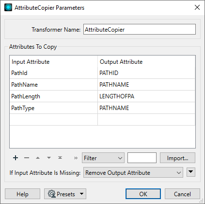

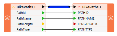

You can replace manual attribute connections with an AttributeCopier transformer. In this example, FME doesn’t connect the attributes because either the case is different or the name is different.
If you right-click on the existing connection and choose Auto Connect Attributes, FME will guess at the connections, connecting the attributes where only the case is different.
PathLength is not automatically connected to LENGTHOFPA, as the two names are too different for an automatic match. You would need to connect such an attribute manually.
However, with the above method, if the feature connection is deleted or replaced, the attribute mapping is lost and will have to be redone.

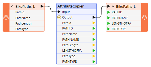

Instead, using an AttributeCopier to map the connections will keep the pairs persistently through changes to the workspace.
And the changes are reflected in the transformer:

When an AttributeCreator is opened for the first time, this area will contain a blank row where a new attribute can be created. Additional rows are added as entries are made.
Input Attribute |
Enter or select the name of an existing attribute from one of the drop-downs. |
Output Attribute |
Enter or select the name of the new attribute to be created if necessary and copied into. The value of this attribute will be the value of the corresponding Input Attribute. If the Input Attribute does not exist on a feature and an Attribute Value is specified, the Output Attribute will be created and set to the value specified in the Attribute Value. |
Default Value |
Enabled when If Input Attribute is Missing is set to Set Default Value. The value to set the Output Attribute to if the Input Attribute does not exist on the feature (a default value). If the Default Value is blank, and the Input Attribute does not exist on the feature, the Output Attribute will not be created. See Defining Values for various methods of setting these. |
If Input Attribute is Missing |
Select an action to take if a specified input attribute has no value: - Remove Output Attribute - Preserve Existing Output Attribute - Set Default Value - enables the Default Value column |
