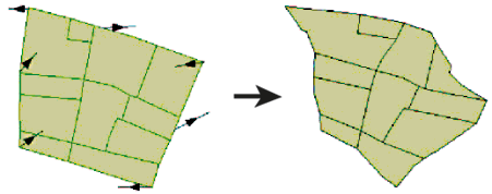

Variably adjusts vector feature coordinates based on their proximity to control vectors indicating current and desired positions.
Applying positional corrections when the modifications are not consistent across the dataset.
The RubberSheeter receives two types of features - those to be adjusted (Observed) and those that describe how that adjustment is done (Control vectors and Constraints).
Observed features can have any type of vector geometry.
Most Control vectors have two points. The start point is located somewhere in the Observed features’ space, and the end point is the desired new location of that point.
A Control vector with only one point indicates that a location should not move - often called a tie point.
Each vertex is modified differently, depending on how close it is to nearby Control vectors (using inverse distance weighting). Only Control vectors that start within the specified Max Distance are used to calculate the new position. This can result in part of a feature being transformed and part of it remaining as is.
