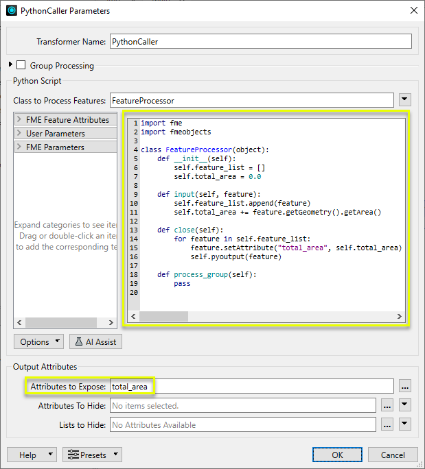

Standard Mode
This is the operation mode when no attributes are set in the Group By parameter. Most uses of the PythonCaller will use standard mode processing. In this mode, the PythonCaller will have the following calling sequence on a class:
- __init__() - Called once, whether or not any features are processed.
- input() - Called for each FMEFeature that comes into the input port.
- close() - Called once, after all features are processed (when no more FMEFeatures remain). If no features are processed, the close() method will still be called.
Features that need to continue through the workspace for further processing must be explicitly written out using the pyoutput() method. When using the pyoutput() method, it is recommended to set the output_tag argument to PYOUTPUT.
As of FME 2023.1, bulk mode is enabled by default for the PythonCaller. This allows for significant performance gains when processing large numbers of features. In bulk mode, FME will pass features to the `input()` method which come from a feature table object. The following conditions must be met:
- features passed into the input() method cannot be copied or cached for later use
- features cannot be read or modified after being passed to the pyoutput() method
- Only features passed into the transformer can be output from the transformer. Newly instantiated FMEFeature() objects should not be output from the transformer. Not every feature passed into the transformer needs to be output from the transformer.
- Group processing must not be enabled
Violations will cause undefined behavior. If PythonCaller usage does not meet these requirements, bulk mode should be disabled by altering the has_support_for() method to return False when the support_type argument is equal to fmeobjects.FME_SUPPORT_FEATURE_TABLE_SHIM.
When the PythonCaller implementation processes incoming FMEFeatures one at a time, the pyoutput() method is to be called once per incoming FMEFeature in the input() method.
When the PythonCaller implementation requires knowledge of multiple FMEFeatures to process features, the incoming FMEFeatures can be stored in a list, then processed and written out through pyoutput() in the close() method.
The example below calculates the total area of all the features processed and then outputs all the features with a new attribute containing the total area. Note that since features are cached for later use, bulk mode should not be enabled.

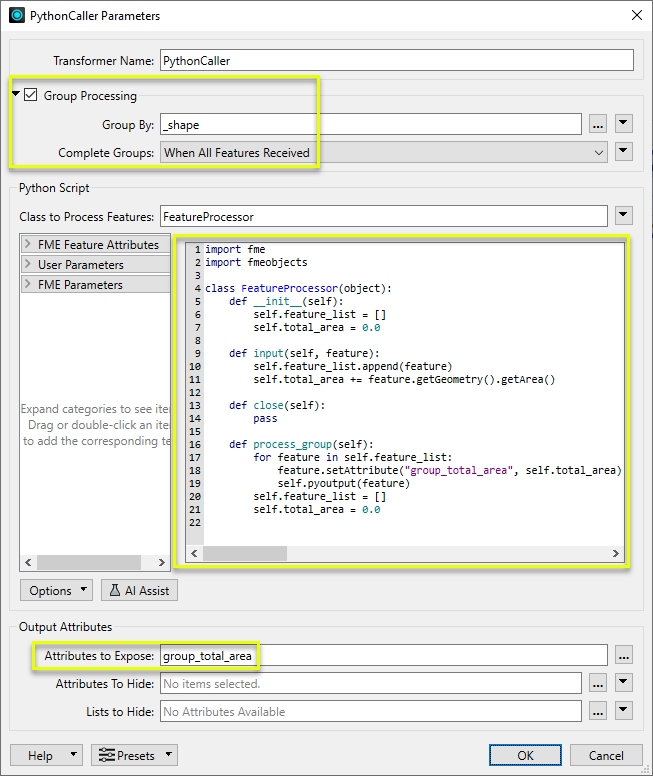

Group Processing Mode
This is the feature processing mode used when one or more attributes are set in the Group By parameter. When using this mode, bulk mode must be disabled by altering the has_support_for() method to return False when the support_type argument is equal to fmeobjects.FME_SUPPORT_FEATURE_TABLE_SHIM.
- input() - Called for each FMEFeature in a group.
- process_group() - Called after all FMEFeatures in a group have been sent to input(). After this is called and executed, PythonCaller will send the next group of FMEFeatures to input() and then call process_group() again. This is repeated until all groups have been exhausted.
- close() - Called once, after all rounds of input() and process_group() have been called to process all incoming features (when no more FMEFeatures remain). If no features are processed, the close() method will still be called.
In this mode, the class interface will be working on groups of FMEFeatures. The incoming FMEFeatures must be stored in a list class member variable, then processed and written out through pyoutput() in the process_group() method. After processing is complete in process_group(), all class member variables should be cleared for the next round of group by handling. In the next round, FMEFeatures of the next group are passed through input() calls followed again by process_group(). This is repeated until all the groups are exhausted.
The example below calculates the total area of all features grouped by the _shape attribute and then outputs all the features with a new attribute containing the total area for each group:
