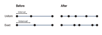

Spacing is specified in ground units, and the placement is guided by Mode:
- Exact Interval: Vertices are added at the specified interval after each existing vertex.
- Uniform Interval: Each segment of the feature is considered individually. The segment receives new vertices dividing it into equal parts. The number of parts is guided by the Interval value, and the distance between vertices can vary between segments.

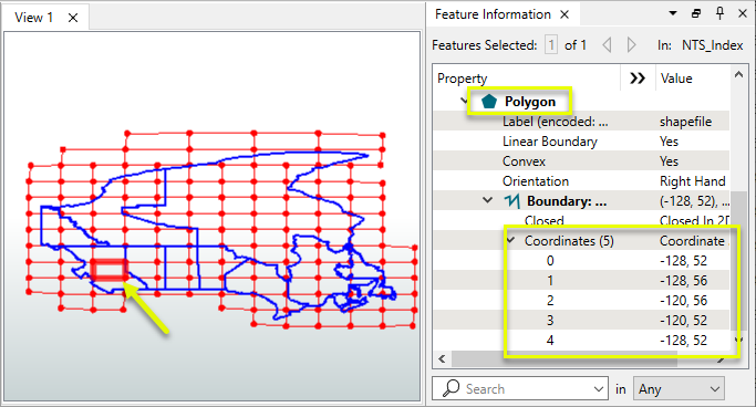

In this example, we have a set of polygons representing mapsheet boundaries across Canada. They are in a lat/long geographic coordinate system, and they are rectangles with points only at each corner.
Provincial boundaries are also displayed for reference.
We want to work in British Columbia, at the far west end, and so reproject to a suitable coordinate system for that area.

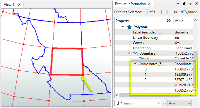

The straight edges of the polygons are still straight - which does not accurately represent where they fall in this UTM projection. The lines of latitude should curve.

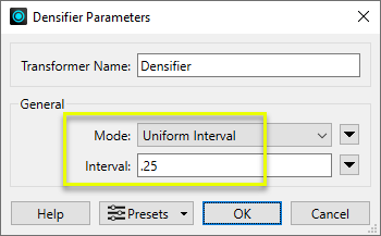

The features are routed into a Densifier prior to reprojecting.
In the parameters dialog, an interval is set to add additional vertices along the feature. This is in ground units - in this case, degrees.

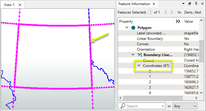

The reprojected feature is much more accurate.

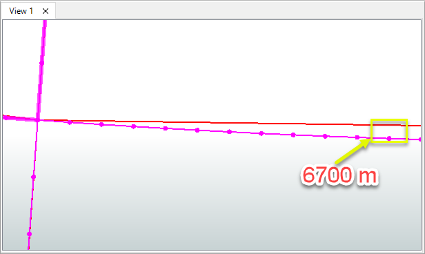

The positional difference between a two-point line and the densified line can be substantial.
