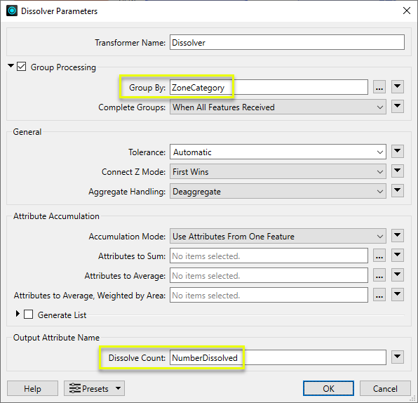

In this example, we have a set polygons representing zoning. They are color-coded by the Zone Category. There are multiple Zone Names within each category.
We want to combine the areas by category, generalizing the areas.
The features are routed into a Dissolver.
In the parameters dialog, Group By is set to ZoneCategory, so that each category will be evaluated for dissolving separately.
The Dissolve Count output attribute is given a name.
Areas have been dissolved according to category. Note the NumberDissolved attribute containing the count of polygons that went into the output area.

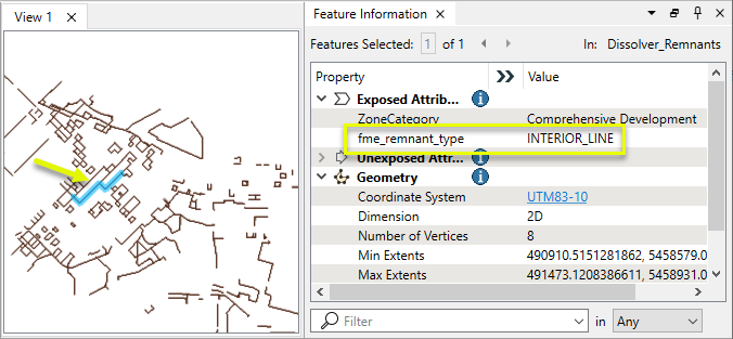

The remnants are also output.

Geometries left over after dissolving. Remnants receive an fme_remnant_type attribute with one of the following values:
- INTERIOR_LINE: The remnant is a portion of the input polygons that was either collinear with another feature or inside an overlapping region.
- UNUSED_DATA: The remnant is a feature that was not used at all in creating the output areas.
