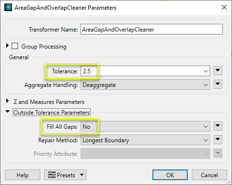

Tolerance: Just Right
The features are routed into an AreaGapAndOverlapCleaner.
In the parameters dialog, Tolerance is set to 2.5 - a value that is less than the width of valid gaps, but large enough to capture the errors.
Gaps and overlaps are repaired.
Valid gaps are preserved and feature shapes are intact.
