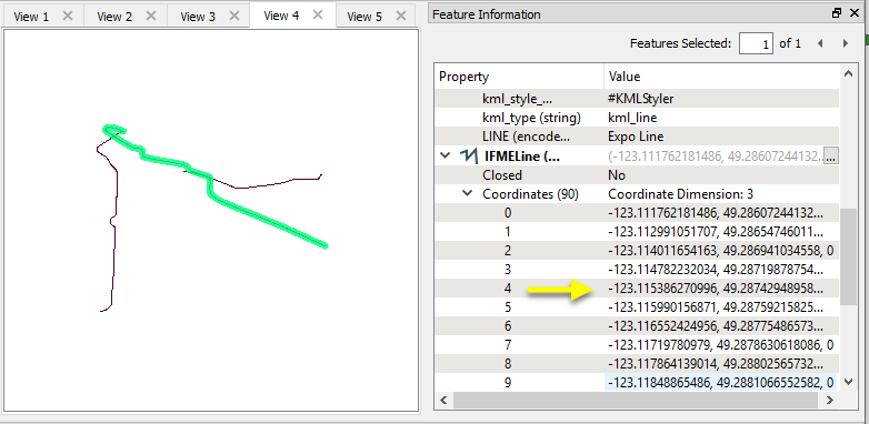

In this example, we create buffer zones around rapid transit lines. The source data is KML, in a geographic lat/long projection.
As the ground units are in degrees, the data must be reprojected before making calculations in units like meters or feet. The GeographicBufferer will take care of that.

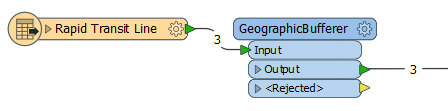

The lines are routed into the Input port.

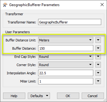

In the parameters dialog, we select Meters as our ground unit of choice, and set a Buffer Distance of 150.

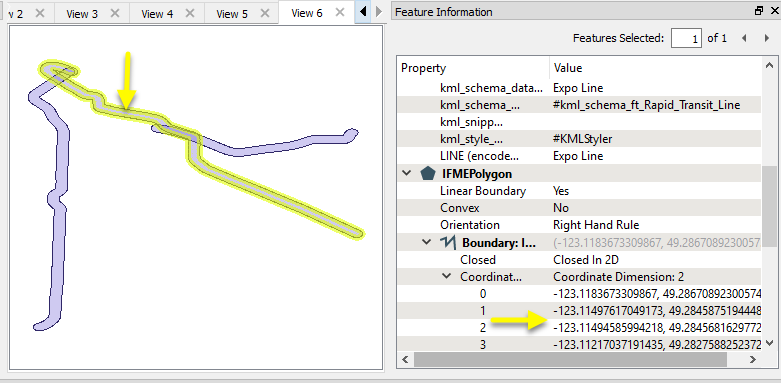

The resulting Output buffer polygons retain the attributes of the original features, and are projected in the original lat/long coordinate system.
