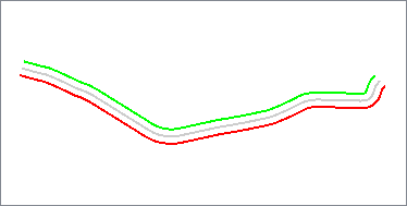

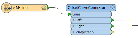

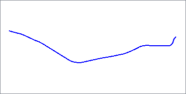

In this example, we will create offset lines on either side of a rapid transit line. The original feature is a single line.
The line is routed into the Lines input port.

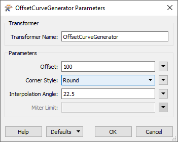

In the parameters dialog, we set the Offset to 100, which will create the new offset lines 100 meters away from the original feature (which is in a UTM projection, ground units in meters). The Corner Style chosen is Round.
Two new lines are output from the transformer - one on the left side of the original line (shown in green), and one on the right (shown in red).

| Offset | This parameter, measures in ground units, specifies the distance by which the output curve is offset from the input curve. |
| Corner Style |

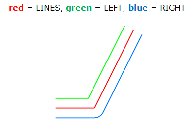

As the diagrams below illustrate, the corner styles of the offset curves can be Round (default), Bevel (chopped), or Miter (pointed). If Miter is used, a limit must be specified using the Miter Limit parameter. If a corner is too pointed for the miter limit, the corner will instead be bevelled. Round
Bevel
Miter
| Interpolation Angle |
This parameter, measured in degrees, controls the smoothness of the stroked arcs in the output offset curve. As this parameter decreases in value, the smoothness of the arc connectors increases. The specified value must be between 0 and 90 degrees. |
| Miter Limit |
Miter Limit This parameter controls how pointed a buffered corner can be before it is beveled. It is the highest value that the ratio of corner distance to offset is allowed to have before truncation occurs. A higher number allows for more extreme corner angles.
