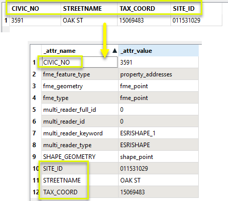

The AttributeExploder receives features with attributes, and extracts both the attribute names and their values. It can do one of two things with them (the Exploding Type) - either create multiple new features (one for each attribute), or add the information to the original feature as a list attribute.
The following examples demonstrate both Exploding Types, as they apply to a single feature. Note that in both cases, extra attributes that are normally unexposed are also exploded, including reader and internal fme_ attributes.
You may opt to either keep or discard the original attributes and geometry - in these examples, they are discarded.
Exploding Type: Features
If the attributes are exploded into Features, each input feature will become many - one for every attribute in the original feature. The new features will have both the original attribute names and values added as new attributes. Below, we use the default new attribute names _attr_name and _attr_value.
One (1) feature becomes twelve (12).
In the case of a spreadsheet, where a row is considered a single feature, this is the equivalent of exploding every cell into its own feature.

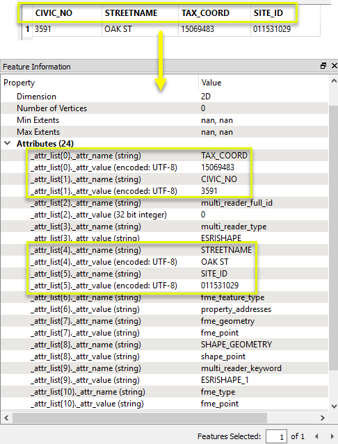

Exploding Type: List
If the attributes are exploded into a List, a new list attribute is added to the original feature.
The attribute names and values are added as list elements.
One (1) feature in produces one (1) feature out, with a list attribute.

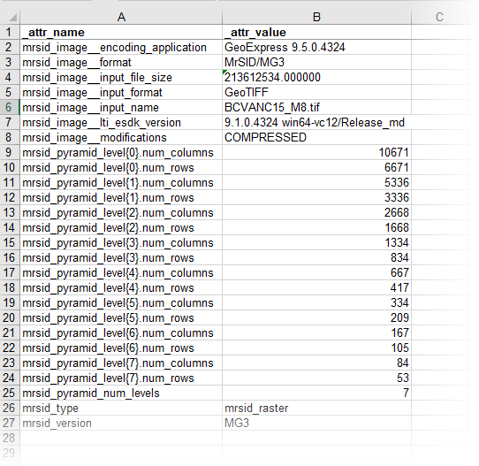

In this example, we will use an AttributeExploder to write out the attributes of a MrSID raster for documentation. One raster tile is considered a single feature.

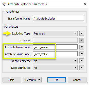

In the AttributeExploder parameters dialog, the Exploding Type is set to Features, and the default label names are kept.

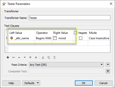

As the output will contain extra attribute types that we don’t want (reader and fme_ internal attributes), we configure a Tester to keep only features where _attr_name begins with the string “mrsid”.
With an Excel writer, a spreadsheet is created (one row per feature), containing both the attribute names and values for the original raster.
