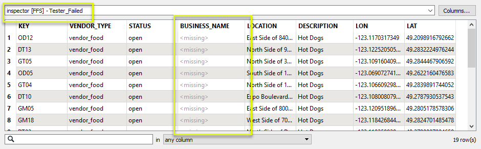

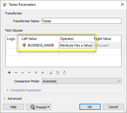

In this example, we start with a dataset of food trucks, and want to identify any records that are missing a Business Name.
The features are routed into a Tester.
In the parameters dialog, we configure one test. The Left Value is set to the BUSINESS_NAME attribute, and the Operator is set to Attribute has a value.
As there is only one test, the Pass Criteria (AND/OR/Composite) is not relevant.
No Right Value is required, as the test is simply looking for the existence of any value.
Features that fail the test are output via the Failed port, and can be sent for further processing elsewhere.

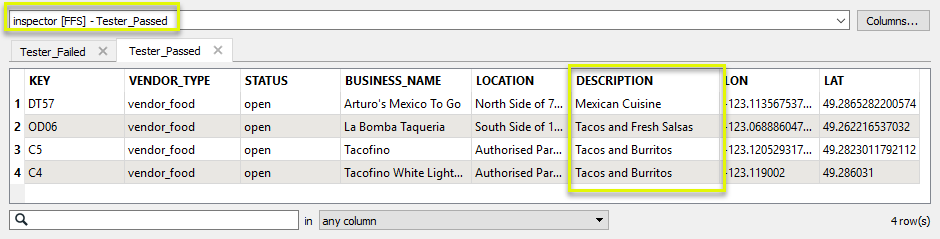

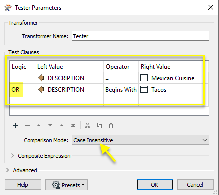

In this example, we start with a dataset of food trucks, and wish to test for those that are serving Mexican food. The features are routed into a Tester.
In the parameters dialog, we construct two tests, both using the DESCRIPTION attribute as the Left Value.
The first test looks for an exact match - any feature where the DESCRIPTION is Mexican Cuisine. The second test is less strict - it looks for any values that begin with Tacos.
The Logic connector is set OR - meaning any feature that matches either of these tests will be output via the Passed port.
Comparison Mode is set to Case Insensitive, which will apply to both test clauses.
Four features match at least one of the tests.

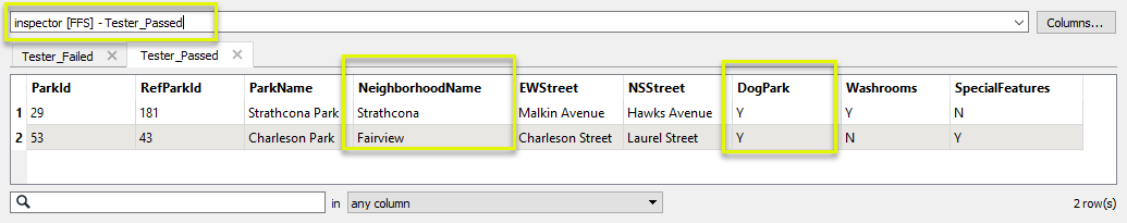

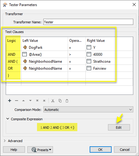

In this example, we start with a dataset of city parks. We will test them to find dog parks of a certain minimum size, in two specific neighborhoods. The features are routed into a Tester.
In the parameters dialog, we add four individual test clauses:
As we have two choices of neighborhood name, we use a Composite Expression to describe the test conditions we want:
The Logic connectors and parentheses can be selected in the Logic column, or entered directly using the Edit button.
Two parks meet the criteria.
