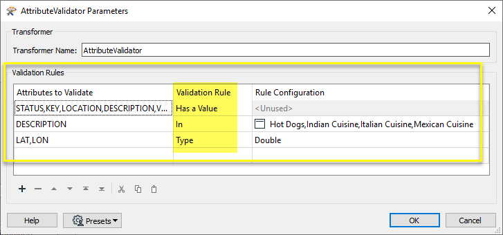

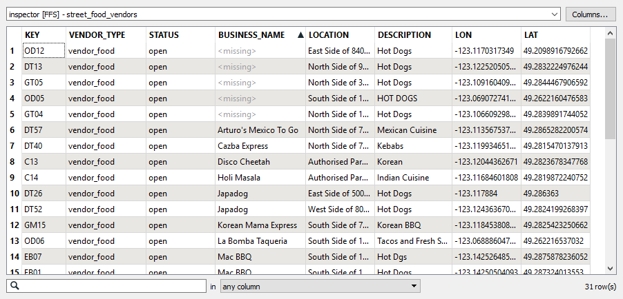

In this example, we have a spreadsheet of food cart vendors to test for data quality.
The features are routed into an AttributeValidator.
In the parameters dialog, we construct three tests to perform:

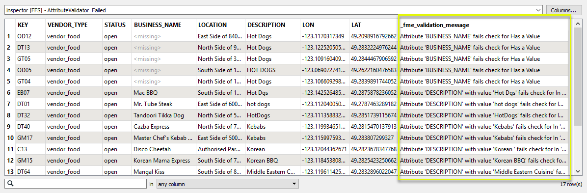

Features that fail any of the tests are output via the Failed port. A new attribute - _fme_validation_message - has been added, and contains details of the first test failed for each feature. Note that the tests are applied in the order they appear in the Validation Rule table.

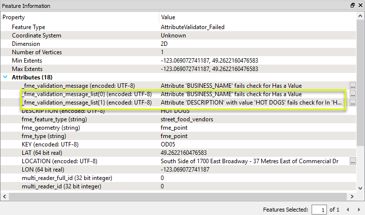

A new list attribute has also been added (which is not visible in the Table view) - _fme_validation_message_list{}. All tests failed are added to the list attribute.
Note that this feature has failed two tests - the BUSINESS_NAME does not have a value, and the DESCRIPTION has failed because the value HOT DOGS does not match the list item Hot Dogs (the case is wrong).
