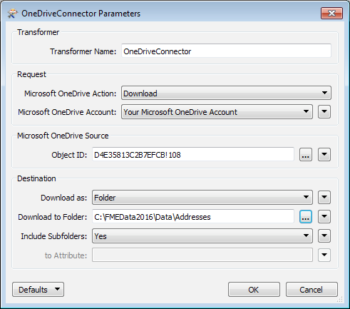

In this example, the OneDriveConnector is used to download an Esri Geodatabase from Microsoft OneDrive. After creating a valid web connection to a Microsoft OneDrive account (which can be done right in the Microsoft OneDrive Account parameter), and browsing to the geodatabase folder, the Object ID is retrieved, and a destination for the download is selected.

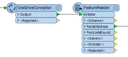

A FeatureReader is added to read the newly downloaded dataset. Here, the PostalAddress feature type will be further processed elsewhere in the workspace.
By executing the download here in the workspace, the geodatabase will be refreshed every time the workspace is run.

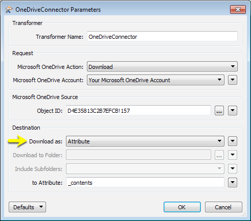

In this example portion of a workspace, the OneDriveConnector is used to download a raster orthoimage from Microsoft OneDrive into an attribute.

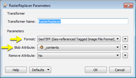

The file is read from Microsoft OneDrive, and the contents stored as a blob attribute. Then a RasterReplacer is used to interpret the blob into a usable raster format.
The combination of these two transformers avoids having to download the image to local storage and re-read it. A similar technique can be used for point cloud files, using the PointCloudReplacer transformer.
