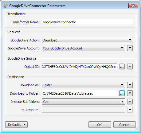

In this example, the GoogleDriveConnector is used to download an Esri geodatabase from Google Drive. After creating a valid web connection to a Google Drive account (which can be done right in the Google Drive Account parameter), and browsing to the geodatabase folder, the Object ID is retrieved, and a destination for the download is selected.

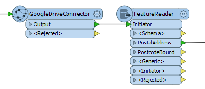

A FeatureReader is added to read the newly downloaded dataset. Here, the PostalAddress feature type will be further processed elsewhere in the workspace.
By executing the download here in the workspace, the geodatabase will be refreshed every time the workspace is run.

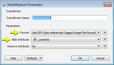

In this example portion of a workspace, the GoogleDriveConnector is used to download a raster orthoimage from Google Drive into an attribute.
The file is read from Google Drive, and the contents stored as a blob attribute. Then a RasterReplacer is used to interpret the blob into a usable raster format.
The combination of these two transformers avoids having to download the image to local storage and re-read it. A similar technique can be used for point cloud files, using the PointCloudReplacer transformer.
