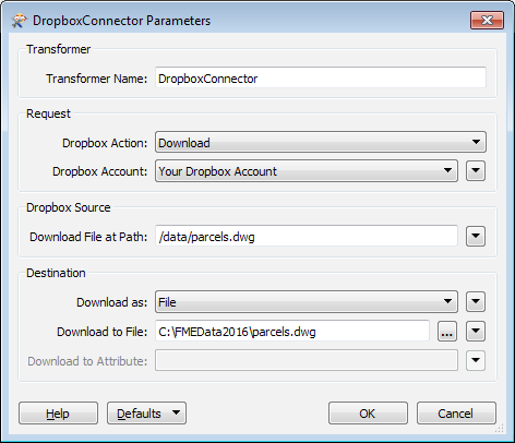

In this example, the DropboxConnector is used to download an Autodesk AutoCAD DWG file from Dropbox. After creating a valid web connection to a Dropbox account (which can be done right in the Dropbox Account parameter), the path and filename to download both from and to are entered.
s

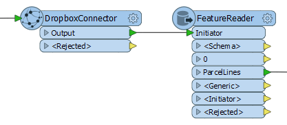

A FeatureReader is added to read the newly downloaded dataset. Here, the ParcelLines feature type will be further processed elsewhere in the workspace.
By executing the download here in the workspace, the source dataset will be refreshed every time the workspace is run.

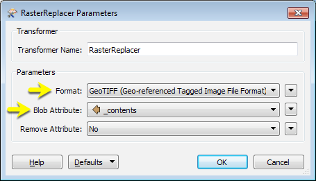

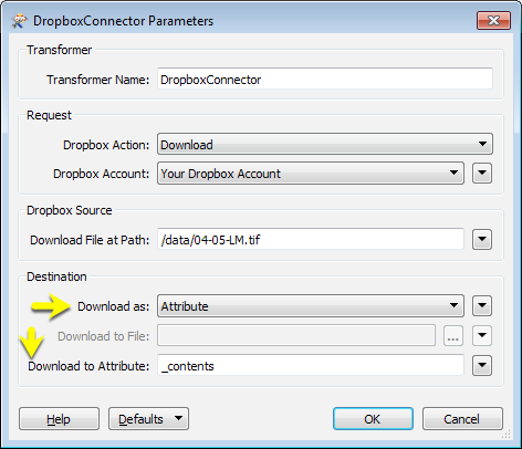

In this example portion of a workspace, the DropboxConnector is used to download a raster orthoimage from Dropbox into an attribute.
The file is read from Dropbox, and the contents stored as a blob attribute. Then a RasterReplacer is used to interpret the blob into a usable raster format.
The combination of these two transformers avoids having to download the image to local storage and re-read it. A similar technique can be used for point cloud files, using the PointCloudReplacer transformer.
