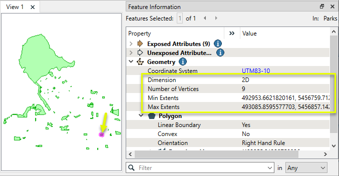

In this example, we have a shapefile of parks, and want to extract their coordinates into an attribute. Note that they are in a UTM coordinate system, with ground units in meters.

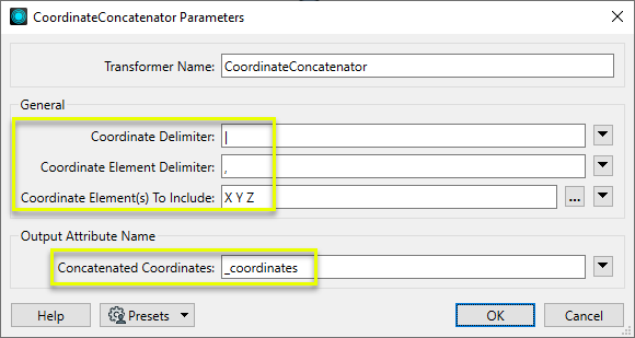

In the parameters dialog, the default settings are kept. Note the delimiters - pipe (|)and comma (,).
X, Y, and Z coordinates are requested by default. Our data is 2D, so the Z will be ignored and these default settings are fine.

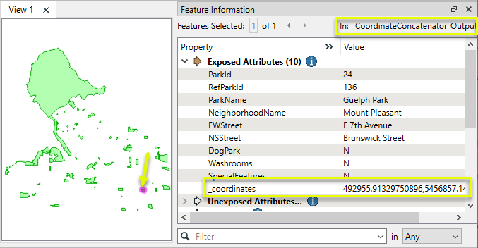

The output features have a new _coordinates attribute.

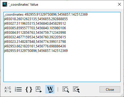

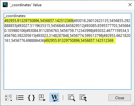

On closer examination of the attribute value, we see the coordinates of the polygon, separated by pipe delimiters. Note that the first and last coordinate are identical - indicating a closed area.

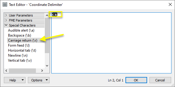

We can use special characters as delimiters to control formatting.

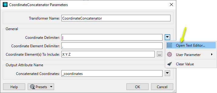

Using the previous example, in the parameters dialog, we access the Text Editor via the dropdown menu on the Coordinate Delimiter parameter.
The default pipe delimiter is replaced with a carriage return character.
The output attribute value now contains coordinates separated by line, which could be written to a text file with an AttributeFileWriter or used elsewhere.
