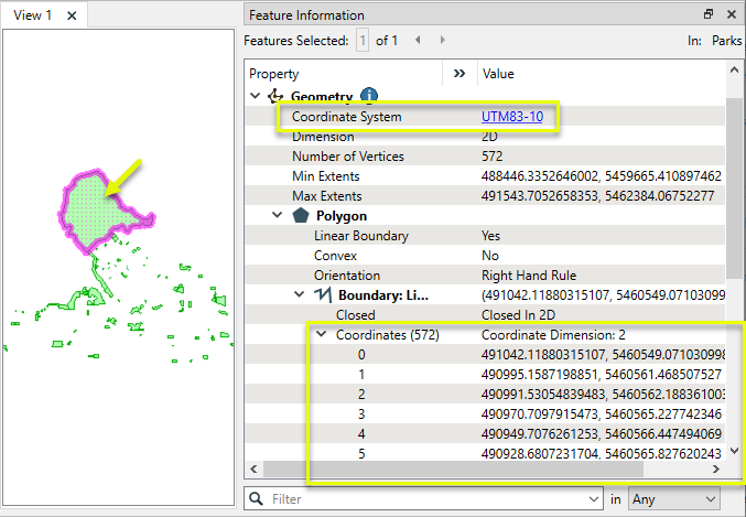

In this example, we have a dataset of park polygons. Note that the coordinate system is UTM83-10, and so the ground units are meters.
Examining the coordinates of individual nodes in one area feature, we see numbers with nine or more decimal places. Considering we are measuring in meters, that precision far exceeds our possible accuracy. We will round the coordinates.

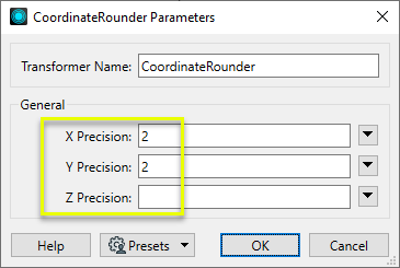

In the parameters dialog, both the X and Y Precision are set to 2, which will round to two decimal places, representing centimeters in this coordinate system.
Z Precision is left blank. The dataset is 2D, and does not have Z coordinates.

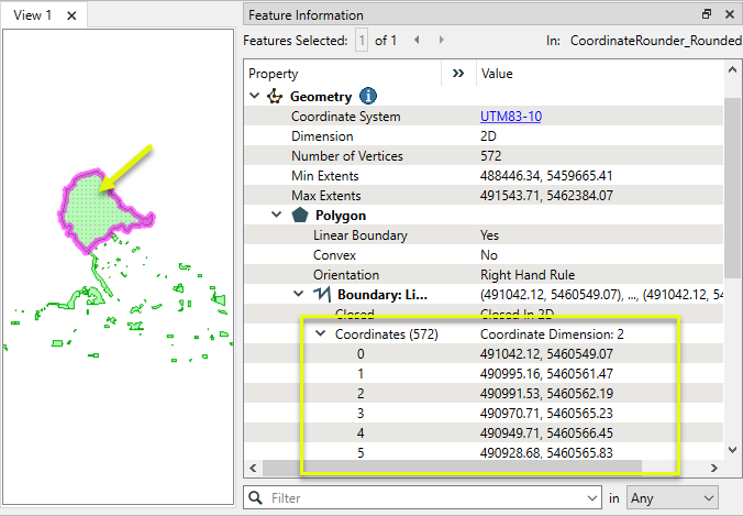

The output features have coordinates rounded to two decimal places.
