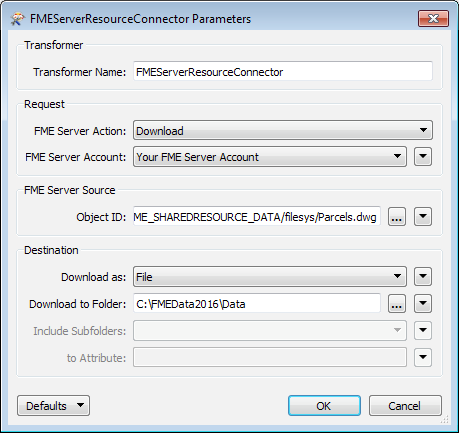

In this example, the FMEServerResourceConnector is used to download an Autodesk AutoCAD DWG file from FME Server file storage. After creating a valid web connection to a FME Server account (which can be done right in the FME Server Account parameter), and browsing to the file, the Object ID is retrieved, and a destination for the download is selected.

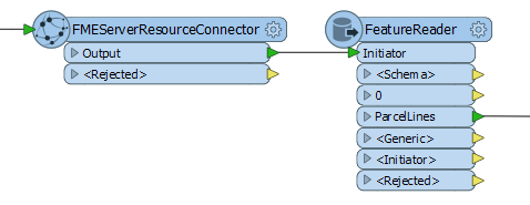

A FeatureReader is added to read the newly downloaded dataset. Here, the ParcelLines feature type will be further processed elsewhere in the workspace.
By executing the download here in the workspace, the dataset will be refreshed every time the workspace is run.

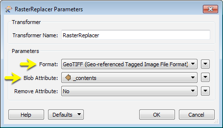

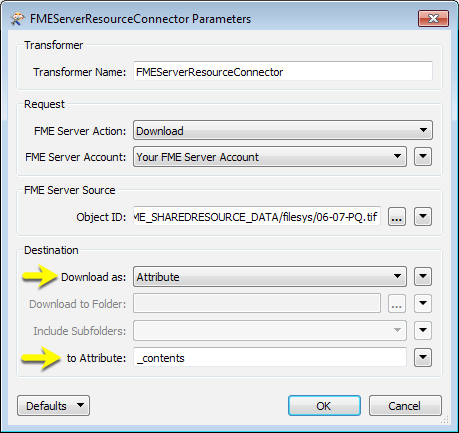

In this example portion of a workspace, the FMEServerResourceConnector is used to download a raster orthoimage from FME Server file storage into an attribute.
The file is read from FME Server file storage, and the contents stored as a blob attribute. Then a RasterReplacer is used to interpret the blob into a usable raster format.
The combination of these two transformers avoids having to download the image to local storage and re-read it. A similar technique can be used for point cloud files, using the PointCloudReplacer transformer.
