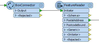

In this example, the BoxConnector is used to download an Esri Geodatabase from Box. After creating a valid web connection to a Box account (which can be done right in the Box Account parameter), and browsing to the geodatabase folder, the Object ID is retrieved, and a destination for the download is selected.
A FeatureReader is added to read the newly downloaded dataset. Here, the PostalAddress feature type will be further processed elsewhere in the workspace.
By executing the download here in the workspace, the geodatabase will be refreshed every time the workspace is run.

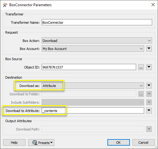

In this example portion of a workspace, the BoxConnector is used to download a raster orthoimage from Box into an attribute.
The file is read from Box, and the contents stored as a blob attribute. Then a RasterReplacer is used to interpret the blob into a usable raster format.
The combination of these two transformers avoids having to download the image to local storage and re-read it. A similar technique can be used for point cloud files, using the PointCloudReplacer transformer.

Download to Attribute |
Specify the attribute that will store the contents of the downloaded file. Valid for Download as Attribute only. Note: FME will attempt to convert the attribute's contents to a UTF-8 string. If this fails, the attribute's contents will be created as raw binary. To ensure that the original bytes are always preserved and never converted to UTF-8, use Download as File instead. |
