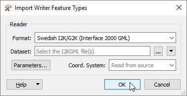

Setting this parameter to Other allows you to provide the GML schema file via the Application Schema parameter. The writer will parse the schema and write out features according to the feature types found in the schema. No other feature types, except the ones specified in the schema, will be written. The writer feature type definitions must then match the ones from the schema.
Tip: Importing the feature type definitions from the reader will also bring in the valid writer feature type definitions accepted by the writer.
Click the OK button to open the Import Writer Feature Types dialog.
Click OK (you can leave the Dataset parameter blank) to proceed to the list of feature types. |
