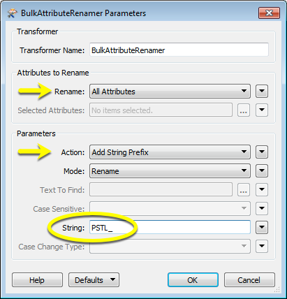

In this example, a prefix is added to all of the attributes.
The output attribute names are altered as requested.

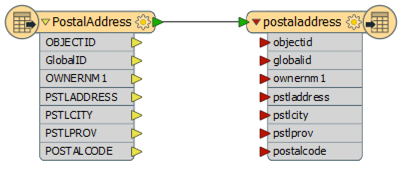

In this example, the source dataset contains attributes with uppercase characters, but the writer does not support that case, requiring lowercase names, and so the attributes are not automatically connected.

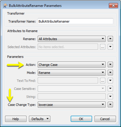

Adding a BulkAttributeRenamer using the Change Case action set to lowercase solves the problem.
The writer attributes are now correctly connected.
