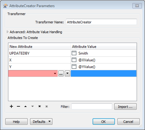

Blank rows are provided where you can enter new attribute names and (optionally) set values for them. One or more new attributes may be added, and all features that pass through the transformer are modified according to these selections.

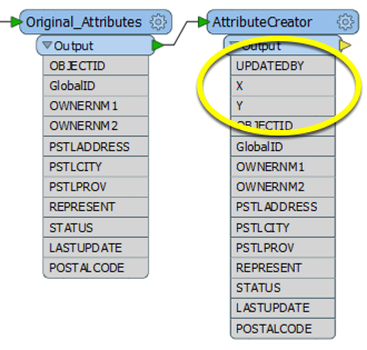

New attributes are added at the top. Duplicate names are not identified, and are not added more than once.
The new attributes are reflected in the transformer, at the top of the attribute list.

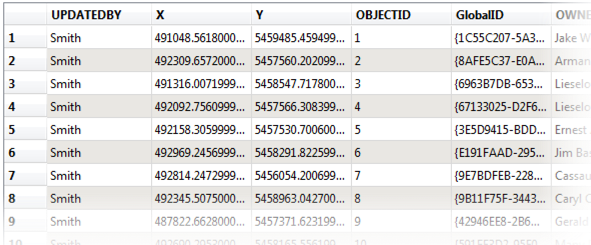

The attribute values are updated, and can be viewed in the Data Inspector’s table view.

When an AttributeCreator is opened for the first time, this area will contain a blank row where a new attribute can be created. Additional rows are added as entries are made.
| New Attribute | Enter the name of the new attribute. |
| Attribute Value |
New attributes can be left without a value for use elsewhere, or you can set new values here by clicking in the appropriate row and:
See Defining Values below for detailed information on using these options. |

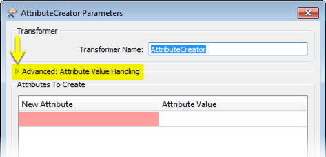

Expanding the Advanced section provides access to the attributes of adjacent features that can be used to define values. While this section may appear complex, most users will rarely need this functionality.
Check “Enable Adjacent Feature Attributes” to use this feature.
