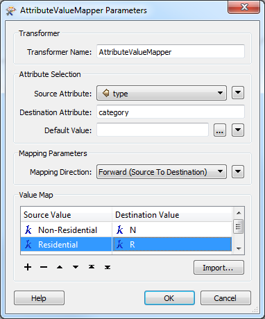

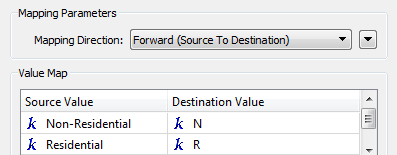

This example maps the values "Non-Residential" and "Residential" of the type
attribute to a new attribute, category
, with values "N" and "R", respectively.
