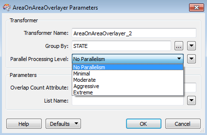

In transformers that support this feature, parallel processing lets you run a transformation as several simultaneous processes. The Group-By parameter allows you to assign features to processes. The Parallel Processing parameter allows you to define different levels of processing, from No Parallelism to Extreme.
In the example here, the Group By parameter is set to STATE based on the reader dataset. By setting the Parallel Processing level, FME can run each state as a separate, simultaneous process.

The level of parallelism (how many processes can be executed at a single time) depends on the Parallel Processing Level parameter, which has five modes:
Depending on the operation performed, one mode can be more advantageous than another, and Aggressive or Extreme does not always provide the best performance: in some workspaces, parallel processing does not provide any advantage; in other workspaces, minimal or moderate levels of parallelism are the best choice (for example, surface-related transformers such as SurfaceModeller or TINGenerator usually work best with these options).
