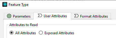

User Attributes
Attributes to Read
Note  User attributes are not available for all formats.
These options allow you to specify the attributes that are read when the workspace is run. Limiting attributes that are read can improve performance, reduce memory consumption, and make workspaces less cluttered.
  • All Attributes – Read all the attributes found in the source data when the workspace is run. The attributes read can differ from those displayed under Attribute Definition (see below).
  • Exposed Attributes – Read only the attributes that are checked in the Exposed column in the Attributes Definition table.
