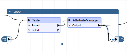

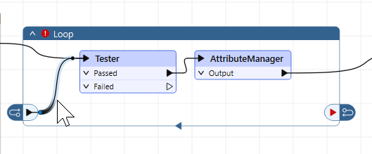

  1. Select the transformers you want to loop and click Loop on the toolbar, or enter Ctrl + L. Alternatively, right-click on the selection and select Create Loop. You can also right-click anywhere on the canvas, select Insert Loop, then drag and adjust the loop block over the desired transformers.
  2. Create a connection from the input port of the first transformer in the loop to the loop output port in the lower left corner of the loop block.
  3. Create a connection from the output port of the last transformer in the loop to the loop input port in the lower right corner of the loop block.
