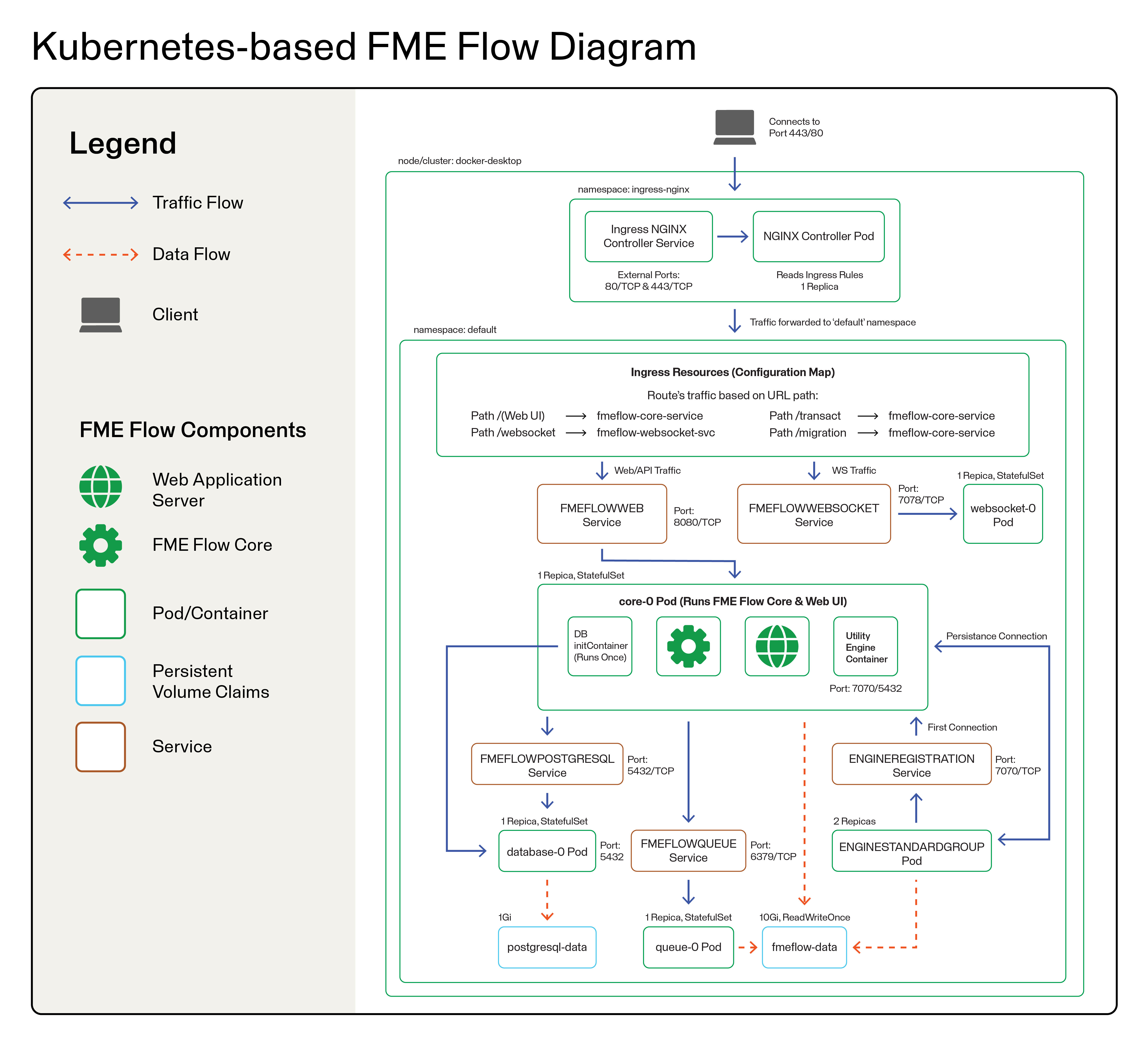

About the Helm Chart for FME Flow
The following diagram depicts a single-node Kubernetes installation using the default Helm chart/values.yaml file.
Mouse over to expand diagram:
