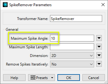

The feature is routed into a SpikeRemover. In the parameters dialog, Maximum Spike Angle is set to 10 degrees.

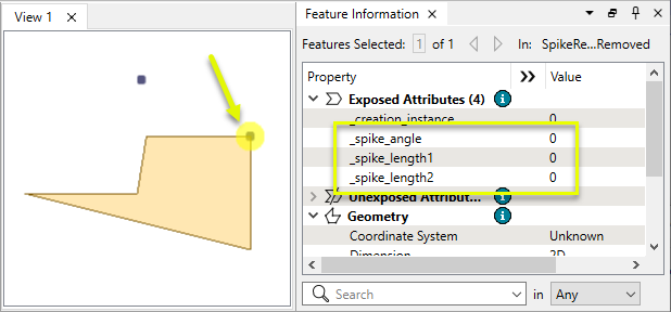

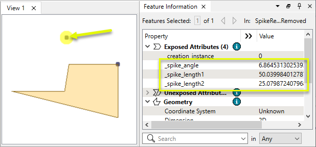

The smaller of the two spikes falls under the maximum, and so its central vertex is removed. The removed vertex is output via the Removed port and receives new attributes indicating angle and length.
Note a second vertex with an angle and length of zero (0). This was a consecutive duplicate vertex, which has also been removed but does not affect the shape of the output geometry.
