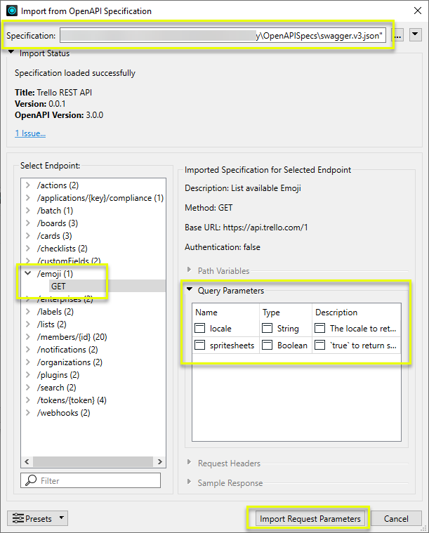

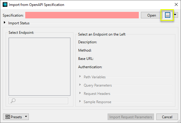

- Use the Select button to access the Import from OpenAPI Specification dialog.
- Provide the file location in the Specification parameter, either with a URL including the .json or .yaml file, or by selecting a downloaded file.
- Select from the available endpoints, and the OpenAPICaller dialog will be populated as specified, including Full Request URL, Authentication Method, and request details such as Query String Parameters and Headers.
Note that any selections made here will overwrite current parameter values.

In the parameters dialog, use the Select button to access the import dialog.
In the import dialog, we navigate to the previously-downloaded specification file.
One the specification file is selected, available Endpoint options are populated.
We select the emoji endpoint, and its GET method. Note the applicable Query Parameters are also retrieved.
Import Request Parameters will apply the selections to the appropriate OpenAPICaller parameters.

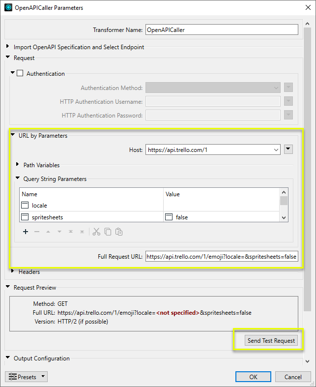

The applicable parameters have been configured.

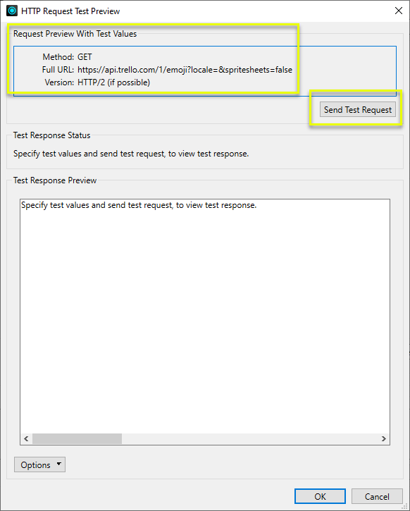

To test the configuration, we use the Send Test Request button.
In the test request dialog, a preview of the query is shown.
Note that if there were any user parameters in the query, they would be available and editable for testing.
Send Test Request will execute the query.

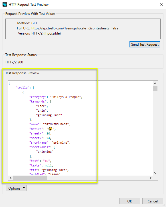

The query test results are returned in Test Response Preview.
These results (and any configuration changes made to user parameters, if present) are saved for future reference but will not affect the transformer's actual parameter settings.
