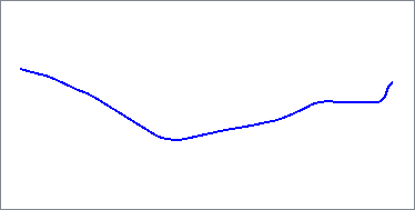

In this example, we will create offset lines on either side of a rapid transit line. The original feature is a single curve.

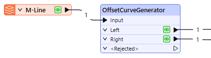

The feature is routed into an OffsetCurveGenerator.

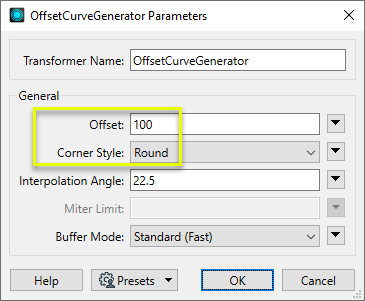

In the parameters dialog, we set the Offset to 100, which will create the new offset curves 100 meters away from the original feature (which is in a UTM projection, ground units in meters). The Corner Style chosen is Round.

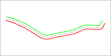

Two new curves are output from the transformer - one on the left side of the original line (shown in green), and one on the right (shown in red).

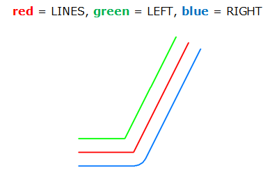

As the diagrams below illustrate, the corner styles of the offset curves can be Round (default), Bevel (chopped), or Miter (pointed). If Miter is used, a limit must be specified using the Miter Limit parameter. If a corner is too pointed for the miter limit, the corner will instead be beveled. Round
Bevel
Miter

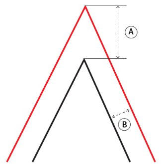

Miter Limit This parameter controls how pointed a buffered corner can be before it is beveled. It is the highest value that the ratio of corner distance to offset is allowed to have before truncation occurs. A higher number allows for more extreme corner angles.
Miter Ratio = Corner distance / Offset
