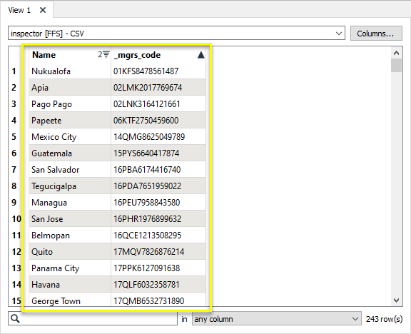

In this example, we have a CSV file of cities with associated MGRS codes. They have no geometry.

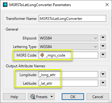

In the parameters dialog, MGRS Code is set to the appropriate attribute. Default attribute names are kept for the coordinates output.

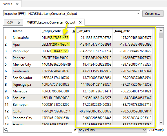

The output features now have attributes containing latitude and longitude coordinates representing the center of the area described by each MGRS code.
Note that in this case, that area is 1 meter square, as the MGRS codes have a precision of 5.
