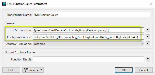

The @Reformat function requires a configuration line. To employ it within a workspace, the function would be called like this:
The configuration line which defines the "BinaryKey" binary structure is specified in the Configuration Line parameter.
